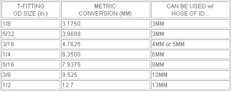

Matt64341 Posted October 26, 2007 Report Share Posted October 26, 2007 I printed out the vacuum diagram and went to go see how easy it was to follow, and it really isn't terrible. I will probably be doing the vac lines very soon. I also located the hose you said might break the s/c. That was the hose that the mouse ate in my engine about 6 months ago. It set off the CEL, and threw a P0304 Piston #4 misfire. I replaced the line after driving 40-50 miles to and from Mazda to pull the code and a couple of autoparts store. It has been at least 5,000 miles and i havn't had any CEL or problems with my s/c. OK found some others. HOWEVER, all sides are the same and the 5/32" size is the outside Diameter of each connection. "its just under a 1/4 of a inche. the inside is about a 1/8 of a inch" -reply from seller. What do you guys think? Will they fit? They are $0.95 each and I have to buy like 55 of them so the price would be the same plus shipping. Who's still interested? -Zao T-Fitting Sizing Chart: I think those should fit, the 5mm hose can fit on a 4.76mm OD fitting, so a 4mm should fit on a 3.97mm OD fitting. Quote Link to comment Share on other sites More sharing options...
