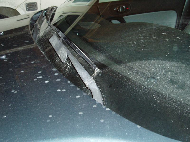

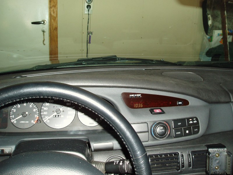

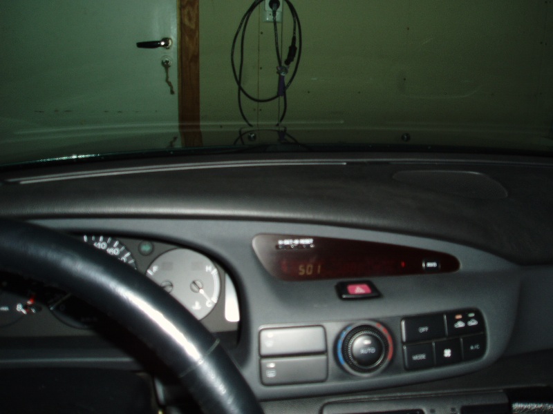

ing-schu@online.no Posted March 26, 2008 Report Share Posted March 26, 2008 I can now confirm that the Millenia hidden wiperarms works on the Xedos. Since the Xedos has no two-position feature, there is one slight downside. The swept area is moved abit towards the hood, leaving a larger area unswept by the driverside a-pillar. No big deal though; I guess about one inch less in the middle, abit more in top corner. [attachmentid=1000] Xedos arms [attachmentid=1001] Millenia arms [attachmentid=1002] Xedos arms inside view [attachmentid=1003] Millenia arms inside view Link to comment Share on other sites More sharing options...

ing-schu@online.no Posted March 27, 2008 Author Report Share Posted March 27, 2008 There are two things I never compromize with. Wipers and tyres. If I couldn't afford top notch, I'd be driving a car too expensive for me. I fitted Bosch Icons (21 and 22) with the new arms, seems to work fine as well as look clean. Link to comment Share on other sites More sharing options...

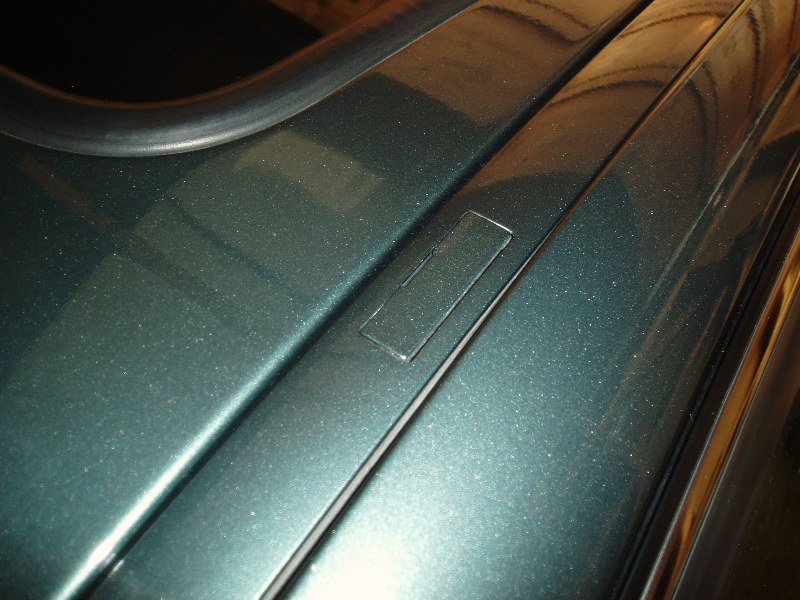

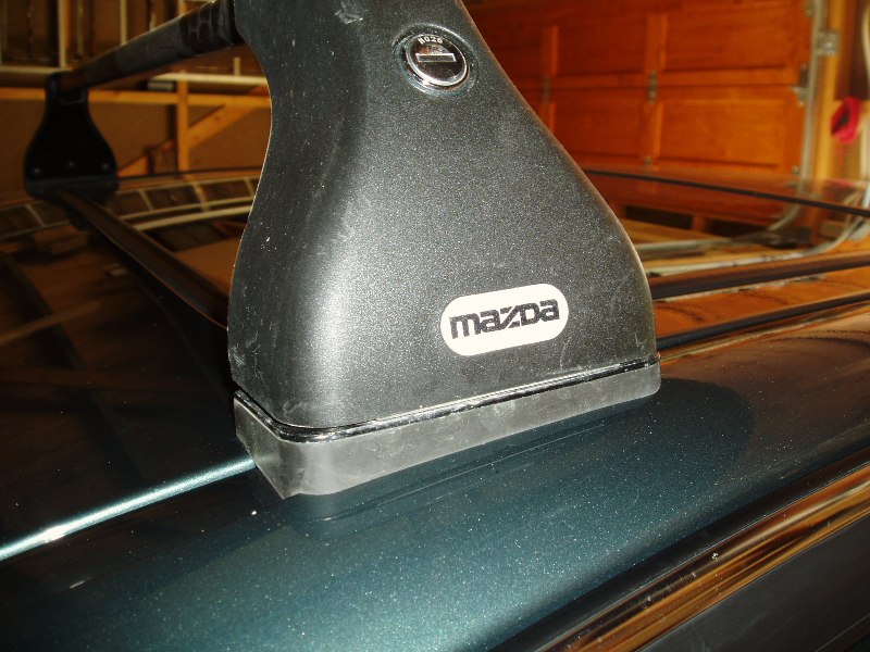

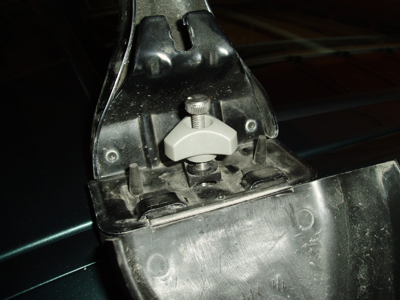

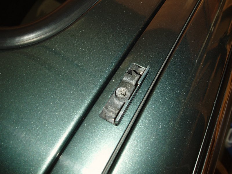

ing-schu@online.no Posted March 29, 2008 Author Report Share Posted March 29, 2008 They look like this: [attachmentid=1008] [attachmentid=1009] [attachmentid=1010] [attachmentid=1011] Link to comment Share on other sites More sharing options...
