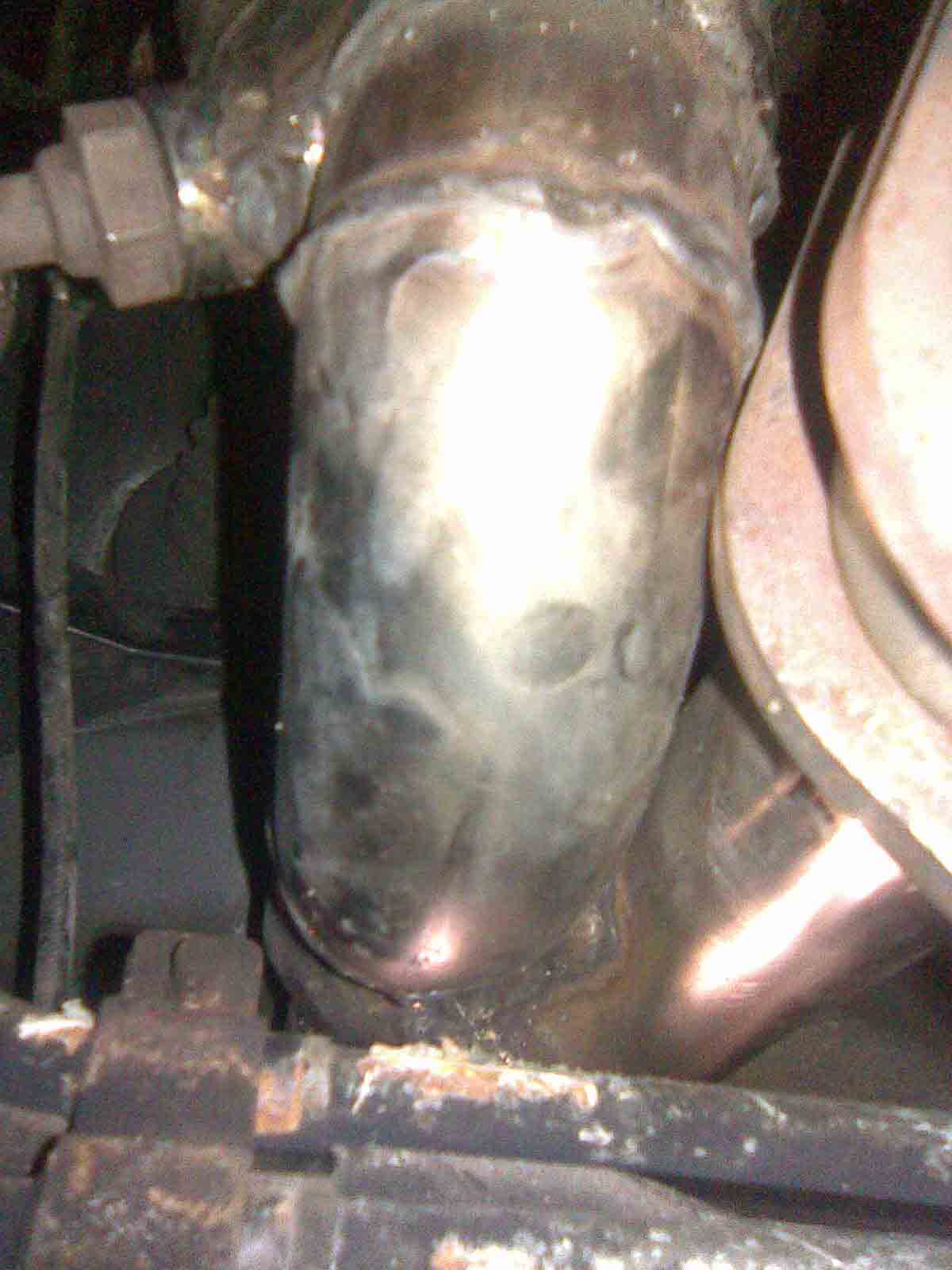

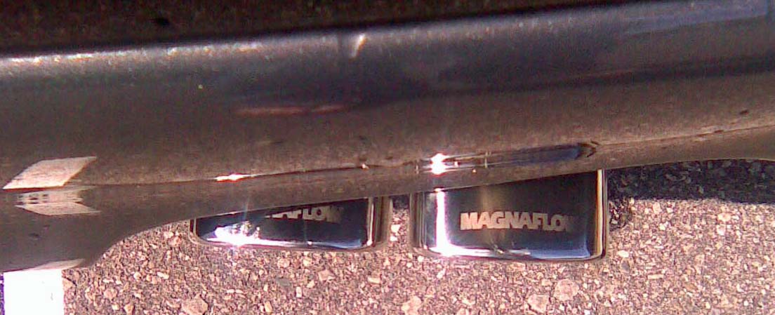

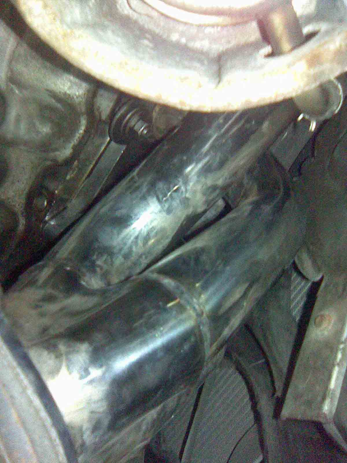

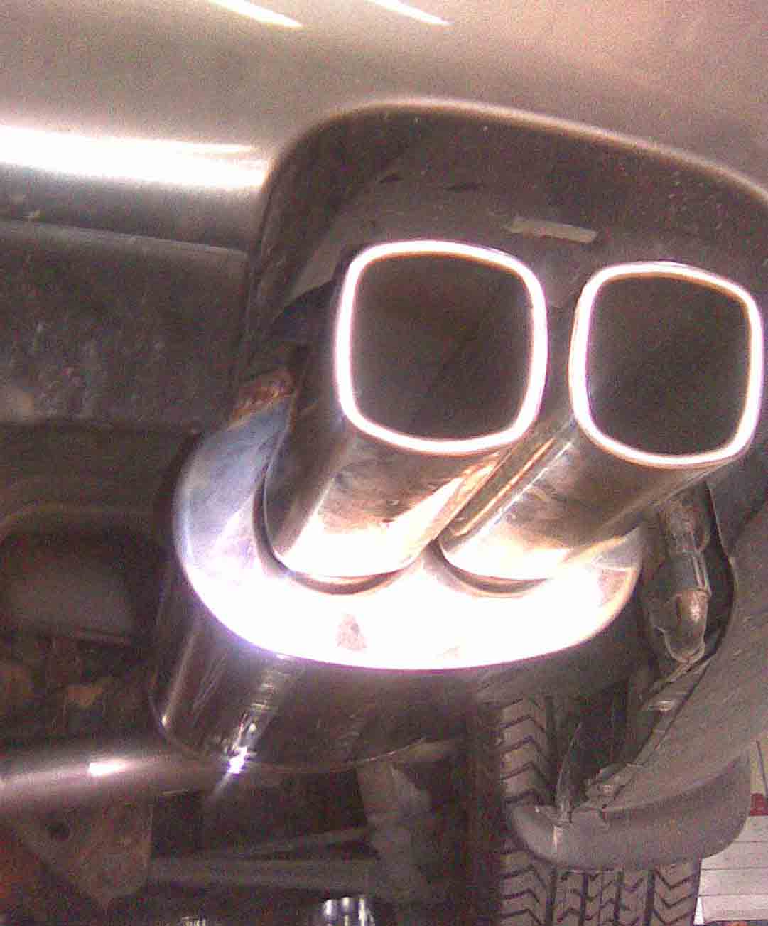

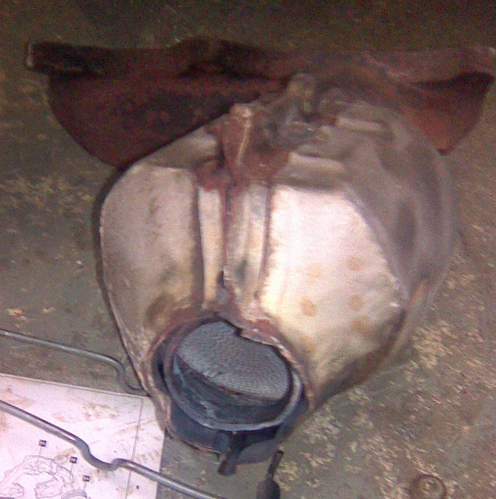

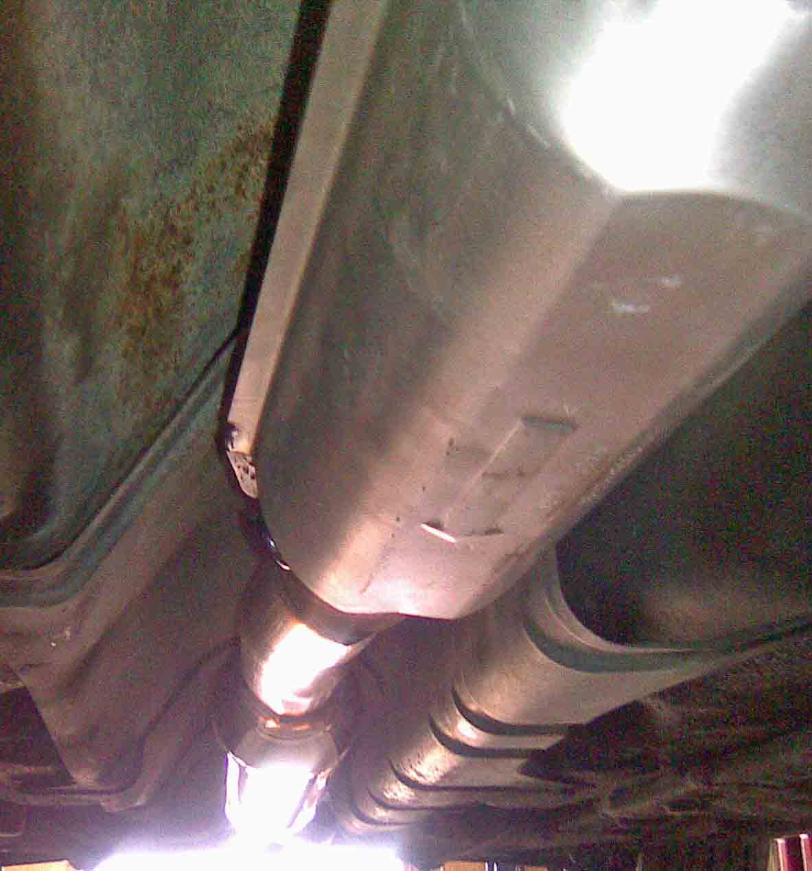

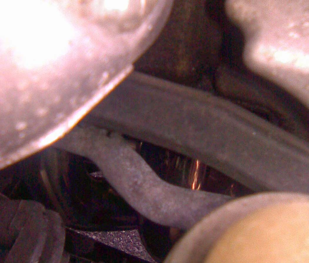

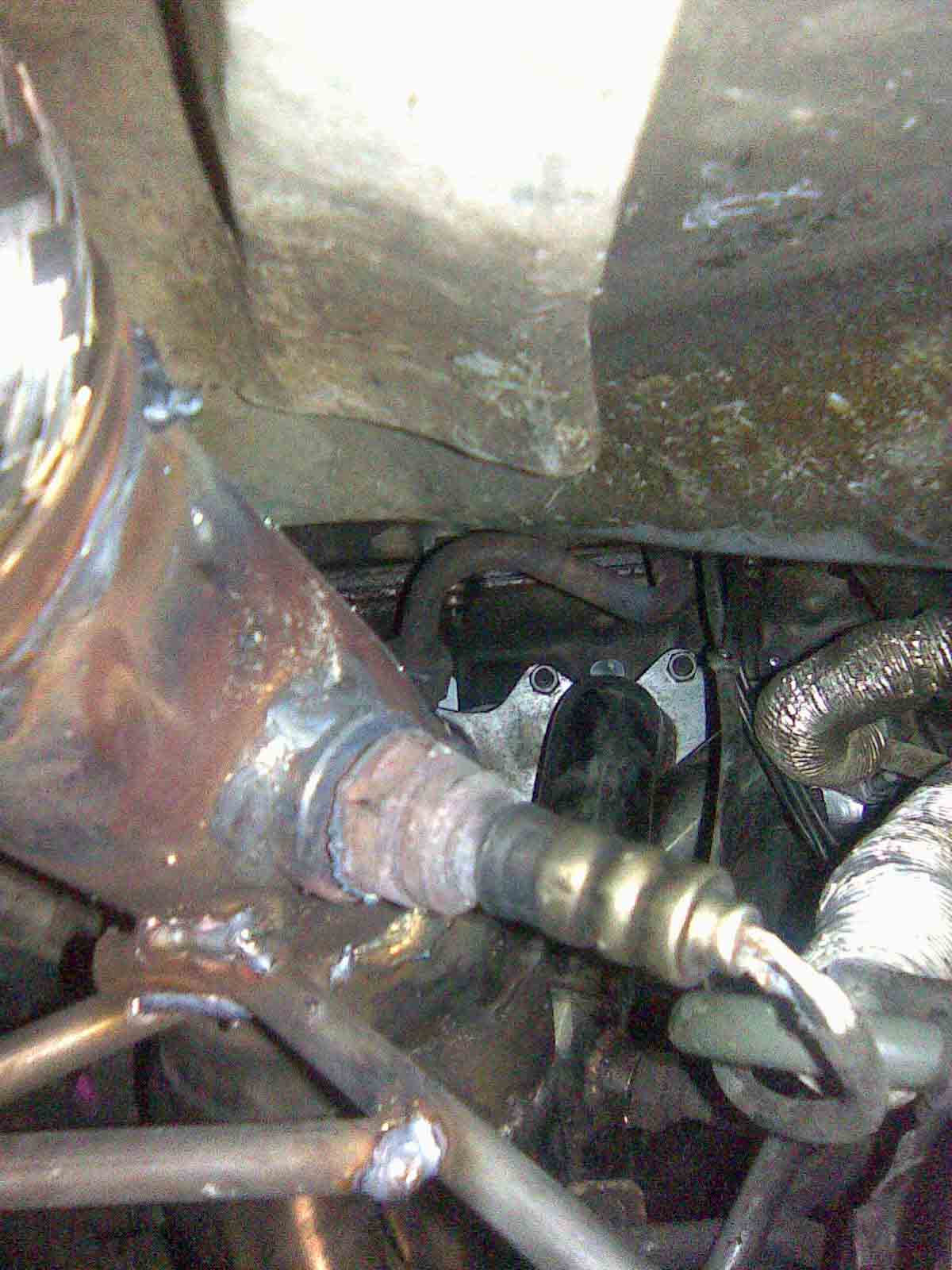

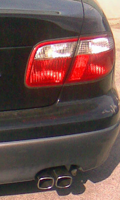

mts Posted July 4, 2008 Report Share Posted July 4, 2008 It is MUCH louder... sound clips have been recorded, but converting from .aac to .mp3 is proving difficult and cannot upload .aac as the extension is not allowed... [attachmentid=1079][attachmentid=1080][attachmentid=1081][attachmentid=1082] [attachmentid=1083][attachmentid=1084][attachmentid=1085][attachmentid=1086] [attachmentid=1087] http://www.zshare.net/download/14693638da90d65a/ Idling at the tail pipe http://www.zshare.net/download/1469373991899a16/ Revving while in Driver's seat http://www.zshare.net/download/146937596ae5745e/ Short drive.... Rear manifold was not leaking at the gasket, rather it was broken on the downpipe side, as you can see in the pic. Came apart in his hands when taking off.... gases were leaking and flowing up through the shield. This created the flawed thought that the gasket was gone... very peculiar. Quote Link to comment Share on other sites More sharing options...

ing-schu@online.no Posted July 4, 2008 Report Share Posted July 4, 2008 Looking good Is the resonator and plumming Magnaflow too? Quote Link to comment Share on other sites More sharing options...
mts Posted July 4, 2008 Author Report Share Posted July 4, 2008 Flex pipe is the special design for turbos, much stronger, resonator is Magnaflow polished stainless, and the pipes are well stainless pipe that he carries... Quote Link to comment Share on other sites More sharing options...

mts Posted July 4, 2008 Author Report Share Posted July 4, 2008 Just had a P0154.... O2 Sensor Circuit No Activity Detected (Bank 2 Sensor 1), well maybe I have an O2 unplugged... or maybe they are not reading well... I still have to move them behind the cat anyway... Quote Link to comment Share on other sites More sharing options...

mts Posted July 6, 2008 Author Report Share Posted July 6, 2008 You will want 2 resonators... it is VERY loud between 2500 and 4000 rpm.... Quote Link to comment Share on other sites More sharing options...
mts Posted July 6, 2008 Author Report Share Posted July 6, 2008 The headers are available on eBay, but they really need to be modified to fit, the bolt pattern is wrong, the collector does not fit, the EGR tube needs to be drastically changed. The rear needs to have the flange cut off and moved to fit up inside. Then a high flow cat and a Magnaflow 18" resonator (not enough BTW second to be installed), then a the Series 40 Maganflow twin square tip muffler. Quote Link to comment Share on other sites More sharing options...
