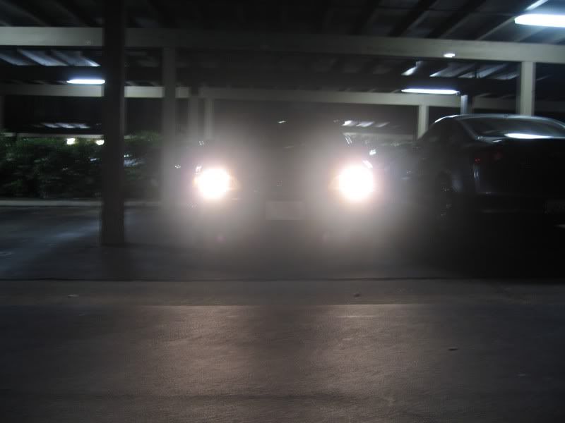

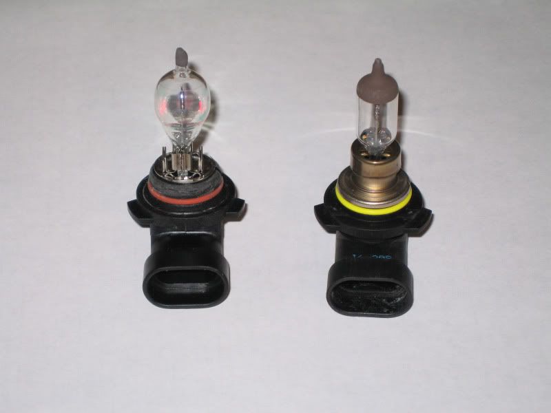

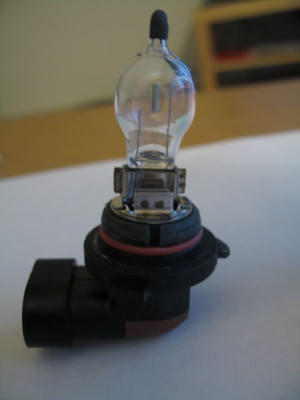

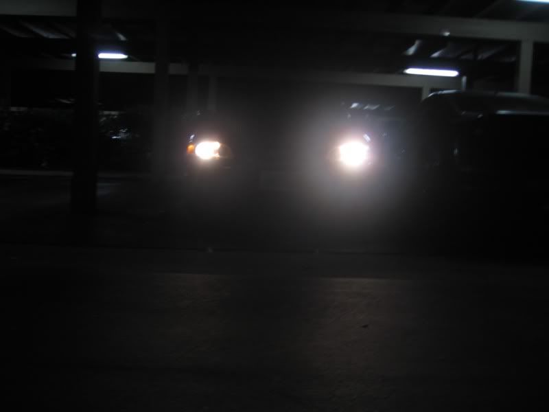

enginph Posted May 20, 2009 Report Share Posted May 20, 2009 I have been using 9012 HIR bulbs for a year and eventually took some pictures to show that they really work. Wiki description: Halogen infrared reflective light sources A further development of the tungsten-halogen bulb has a dichroic coating that passes visible light and reflects infrared radiation. The glass in such a bulb is spherical, rather than tubular. The reflected infrared radiation strikes the filament located at the centre of the sphere, heating the filament to a degree greater than occurs by passing an electric current through the filament. The filament thus superheated emits more light, without an increase in power consumption or a decrease in lifespan. This is a picture of the bulb: This is the bulb next to conventional Phillips bulb: This is my car Left (passenger) is Phillips and right is HIR, observe the color and brightness: This is above the cutoff same setup: This is with both HIR: It takes some time to warm up for HIR, left one is still warming in the last picture. Comparison with regular 9006: http://hirheadlights.com/stats.htm For more info: http://hirheadlights.com Quote Link to comment Share on other sites More sharing options...
