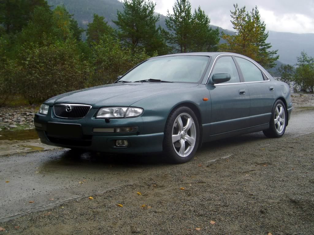

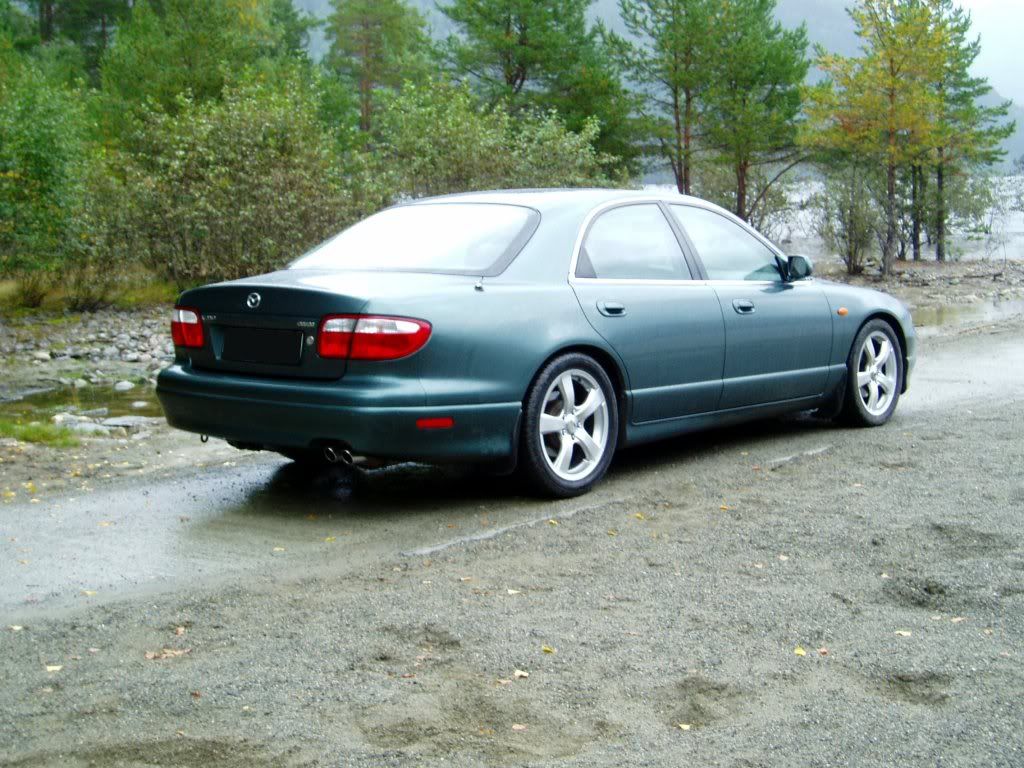

ing-schu@online.no Posted September 11, 2010 Author Report Share Posted September 11, 2010 a torch and a hammer and what else?? My breaker bar Ok, this is the result: Quote Link to comment Share on other sites More sharing options...
enginph Posted September 11, 2010 Report Share Posted September 11, 2010 a torch and a hammer and what else?? My breaker bar And??? Congrads on getting rid of the ugly wheel well space. Looks perfect now... Wish I had lower miles to justify an upgrade like that.. Quote Link to comment Share on other sites More sharing options...
latinopikachu Posted September 11, 2010 Report Share Posted September 11, 2010 OH WOW that looks greatttt.... i want some now and XEDOS can you price a set of those nozzles from the dealer? Quote Link to comment Share on other sites More sharing options...
