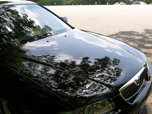

The box has directions but this is the low down. knead the clay up into a ball, and then work back into roughly a 2x4 slap, or whatever works best in your hand. Now, going a single body panel at a time (or half the hood/half the roof) spray the panel with the quik detailer, and I mean spray. roughly a full pull at 10" spaced every 8-14" you have to "feel" what the right amount is for your car.
Now when this is done begin running the clay up and down or side to side. I like up and down myself. Now when you put the clay on the car do not press straight down, always press (with moderate force pushing down mind you) at an angle to make it glide. It you’re doing it right it should glide freely, but in your hand it will feel rough. If the clay stops or smears, your using WAY to little solution.
Your done when the clay glides so freely that you feel NO resistance in the clay. Imagine rubbing wet ice on wet ice, this is what it will feel like. Don't be alarmed if you need to do this a few times. If you've gone over the same spot more then 4-5 times and feel resistance, wipe briefly clean with the large towel (do not buff) then respray and keep at it. Now when it does glide freely take the large towel and wipe it down getting most of the liquid, then take the smaller terry cloth or absorbent microfiber towel and wipe the rest clean and buff it to make sure none remains. Be careful and look carefully from all angles, it’s a sneaky bastard.
Now simply repeat this process for the whole car, you can even do windshields, windows, sunroofs whatever. When your done find that same spot you rubbed with the back of your finger and do the same again, you will notice that the paint feels smoother then it EVER did, even from the factory.
Now the quik detailer has both put in some natural oils to the paint to deepen its shine, but the clay barring has stripped off ALL wax.
What this means is that you MUST rewax the car once done. I know this can take up a good amount of time between the wash, clay barring, and waxing, but it’s worth it.

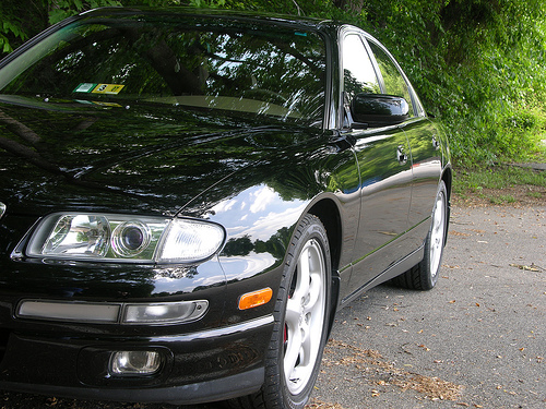

Which meguier do you use? Is it hard to apply, buff. How much elbow grease? Zaino claim it is easier to apply and last longer. I concur zaino stuff looks a little plastic, your baby looks glassy though thumbup1.gif
