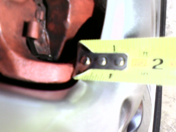

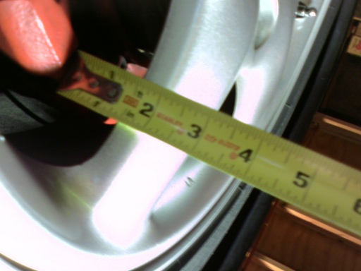

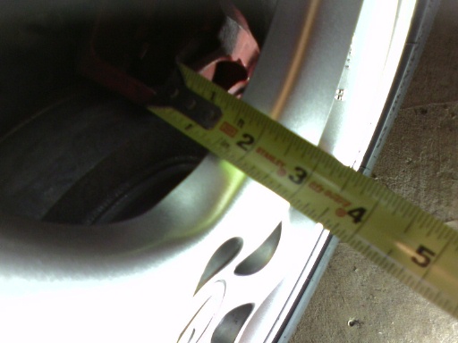

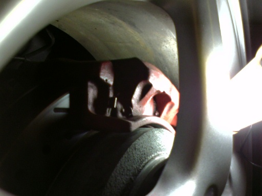

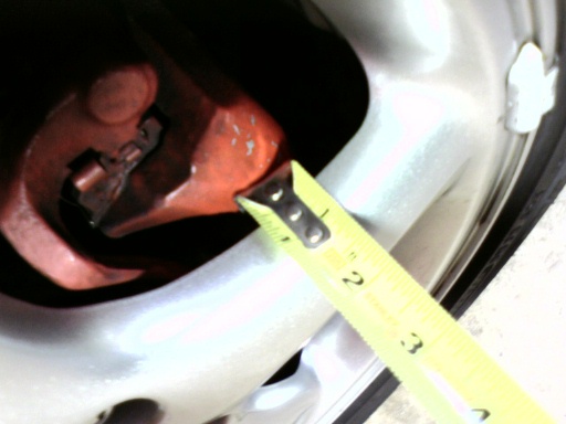

Ren,
I can get you pictures if you need them, but I would worry about the front much more then the back. On the front the stock 17" rims barely clear the caliper as is, I would estimate maybe 12mm of difference, in the rear however they are more recessed since there is the hub for the parking brake.
This could be solved by adding in wheel spacers with the kit, but I would perfer not to go that route on the millenia.
Let me know if you needs pics and or measurements
Ren,
as it so happens I drove the millenia, here are some pics of the clearance, as you can see, on the front there is barely anything, about 4mm at the closest point
On the rear highway the calipers do not extend out any further then the hub and there is a good bit of room, over an inch.

The clearance in the front isn't a problem, I wouldn't use rotors that sit that close to the wheel, they would be deeper and give more clearance. All I need is 25mm deeper rotors which I imagine exist. I will definitely not make a kit that needs spacers.
