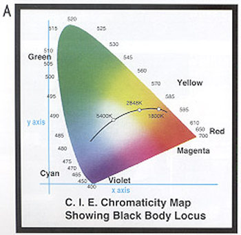

[attachmentid=2]
As youu can see, 4300k, the ONLY oem capsule type used is right in the "sweet spot" if you will

[attachmentid=2]
I know some of you didn't look at the graph like you were suppose to. Here it is again.
This goes back to why there illegal, hids produce roughly 300% more light then halogens, and as I hope you've learned, that applies to real hids or oem quality, however, they are not in hid housings, which means about about extra 250% of the legal light limit is bleeding over your stock cutoff (not shield) and blinding people. now when the little ricer lights get in our eyes its annoying, but it doesn't cause long term damage and blindness.

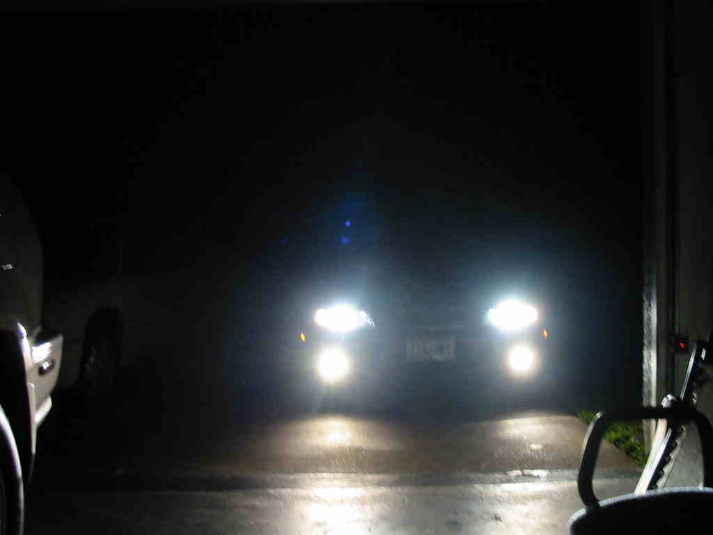

Here is a picture of my millenia with OEM hid parts retrofitted. This is a pic taken in broad day light BELOW the cutoff. Note the EXTREME difference in output and quality.
[attachmentid=5]
[attachmentid=6]
Here is a pic in the same spot of the HIDS off, but the fogs on, and yes, the fogs were on in the first pic

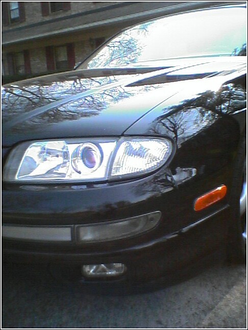

My own custom Retrofit. Project rook about 20 hours total labor. Uses a a Valeo D2S projector and philips 4300k capsule powered by philips gen 4 ballasts.
