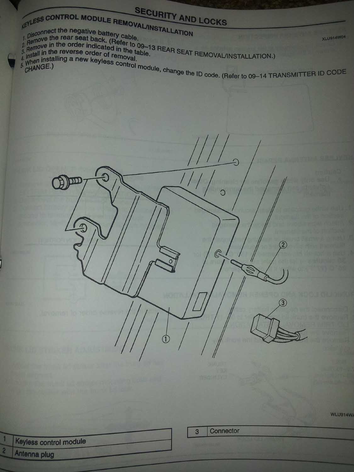

latinopikachu Posted October 21, 2012 Report Share Posted October 21, 2012 the alarm reciever is behind the rear seat. if all else fails one of us here in the states can get you a later model 97-02 that isn't as finicky as yours if the connectors are the same. Quote Link to comment Share on other sites More sharing options...

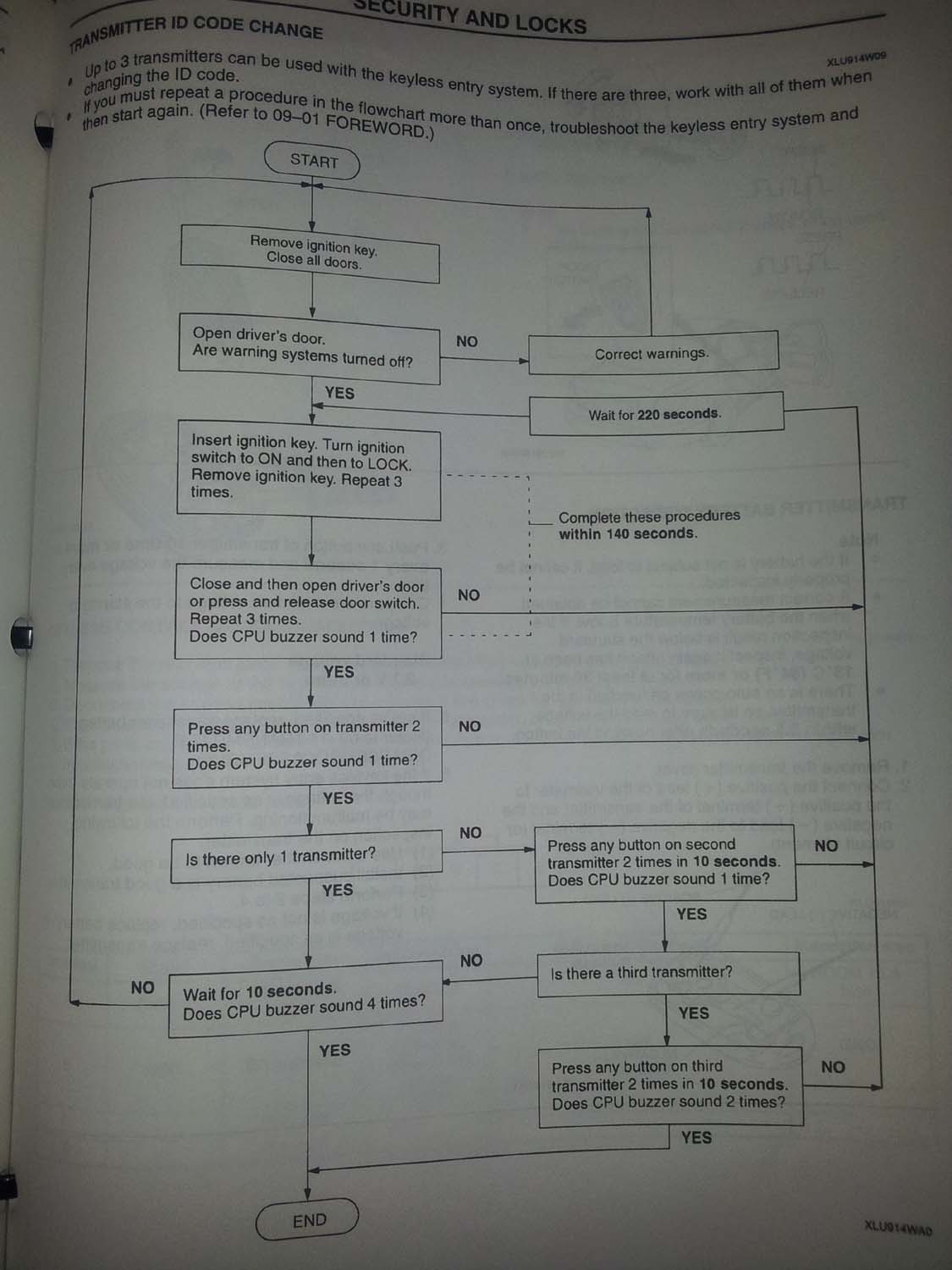

Xerxes Posted October 21, 2012 Author Report Share Posted October 21, 2012 Thanks. My instruction/owners manual mentioned the remote, but with an asterix * behind it. On the bottom of the page it says: "on some models" or something like that. I tried this instruction: _________ 1. Remove key from ignition. 2. Close all doors. 3. Open driver side door and leave open. 4. Insert key in ignition, Turn key to ON (as far as you can go without starting the engine) and OFF, Remove Key. 5. Repeat step 4 two more times, making sure you remove key each time. 6. Close and then open the driver’s door three times. 7. Buzz sound or chime should be heard at this point signaling that the vehicle is now in programming mode. If not, wait 40 seconds and return to step 1. 8. All transmitters need to be programmed at this time, including the old ones. Push any button on a transmitter two times. A buzz sound to chime should be heard at this point signaling that the vehicle has accepted the new transmitter code. Repeat for next transmitter, up to a total of three remotes (including any old remotes). 9. After all remotes are programmed, wait 15 seconds or until you hear four chimes signaling successful programming. _________ Just to make sure I hear a chime after step 6, to see if I can get it into program mode, but it doesn't seem to work. No chime at all. I tried like 15 times or so to no avail. Im beginning to think my 95 build Xedos 9 doesn't have a remote. Can someone tell me where that control module should be in the trunk as stated by Frankzao? Furthermore I mailed 3 different Mazda dealers in the neighbourhood, but they haven't replied so far. I did found my VIN # somewhere in the paperwork and also the name and address of the first owner back in 96. It is in a small village only 15km's away from where I live. Maybe I can see if I can find out if they still live there and just give them a call. They would surely remember if the Xedos they owned came with a remote I presume. On the other hand, wouldn't that be kinda like, you know, awkward or something if some unknown bloke called you 10 years after you sold the car? Quote Link to comment Share on other sites More sharing options...
Xerxes Posted October 21, 2012 Author Report Share Posted October 21, 2012 the alarm reciever is behind the rear seat. if all else fails one of us here in the states can get you a later model 97-02 that isn't as finicky as yours if the connectors are the same. Completely missed that post. Sorry for that. Where behind the rearseat would that module be exactly? Do I have to remove like the back of the seat? I don't completely understand your image. More precise point 2. Remove the rearseat back (refer to 09-13 rear seat removalinstallation). That 9-13 points to the owners manual i presume? Don't have it near me at the moment and I'm going to sleep for an hour or 2 since I'm working nightshift tonight. I will be checking it tomoroow early morning when I get back from work Thanks so much for all the replies so far Quote Link to comment Share on other sites More sharing options...

Xerxes Posted October 22, 2012 Author Report Share Posted October 22, 2012 I see that the image with the procedure that latinopikachu posted is slightly different then what I found and tried. Didn't had a chance to look into it further this morning when I got home; I was completely wasted. Damn nightshifts; lol Is there like a specific time I have to turn the key? Like one second to to ON then one second to LOCK an then remove one second and then the same 2 more times? I'm gonna try that procedure in any case and let you all know. ps: one of the dealers mailed me that they would be able to search what remote I need if I mail them my VIN number. Well since I already know that my colour was only used in 95 I already know that I need the remote with the logo. I'm gonna mail him back and see If he can deliver a new one and see what that costs. If its like 150 euro's or so and a secondhand is around 70 euro's I might just go for a new one. We'll see. First need to try and get the thing into program mode Quote Link to comment Share on other sites More sharing options...
Xerxes Posted October 22, 2012 Author Report Share Posted October 22, 2012 I've been trying again for some 30 minutes or so to get it to program mode but nothing happens. Took a few pictures of the trunk with the backside of the seat pushed aside, bith from the left and the right hand side. I noticed and antenna-like cable on the left that wasn't connected to anything. I thought I read somewhere that the control module would be connected to such a cable, but I'm not sure anymore. I took a few pictures with my cellphone, but I can't find the usb cable to transfer them to my computer, so uploading will have to wait until I find the cable again Furthermore, I found this thread: http://www.mazdaworld.net/forums/index.php...4&hl=remote Refers to some postings by MillyOwner, but the pictures aren't working anymore. It would be a great help If someone was willing to take some pictures of how that module should look. I'm beginning to think that my car doesn't have that module installed since I can't seem to get it into program mode and since I saw that loose antennalike cable on the left side of the trunk. Any idea's? And what if that module is missing, how much would that go for? PS: I just received a mail from one of the Mazda dealers stating that for the 97 model the remote alone would be 305 euro's ex tax, so I bet the 95 model would be somewhere in that same ridiculous pricerange. I dare not think what that control module would cost if a stupid little remote already costs 350 euro's or so :'( Quote Link to comment Share on other sites More sharing options...
///BHRpowered Posted October 22, 2012 Report Share Posted October 22, 2012 woah, I wouldn't bother with dealer prices, search ebay. I think troutman got a US one and it worked on his 95 xedos9 But yes, 95-96 are a bit more. Frankzao took apart the whole thing and transplated to another car. Not sure if theres a visual difference between units. Quote Link to comment Share on other sites More sharing options...
