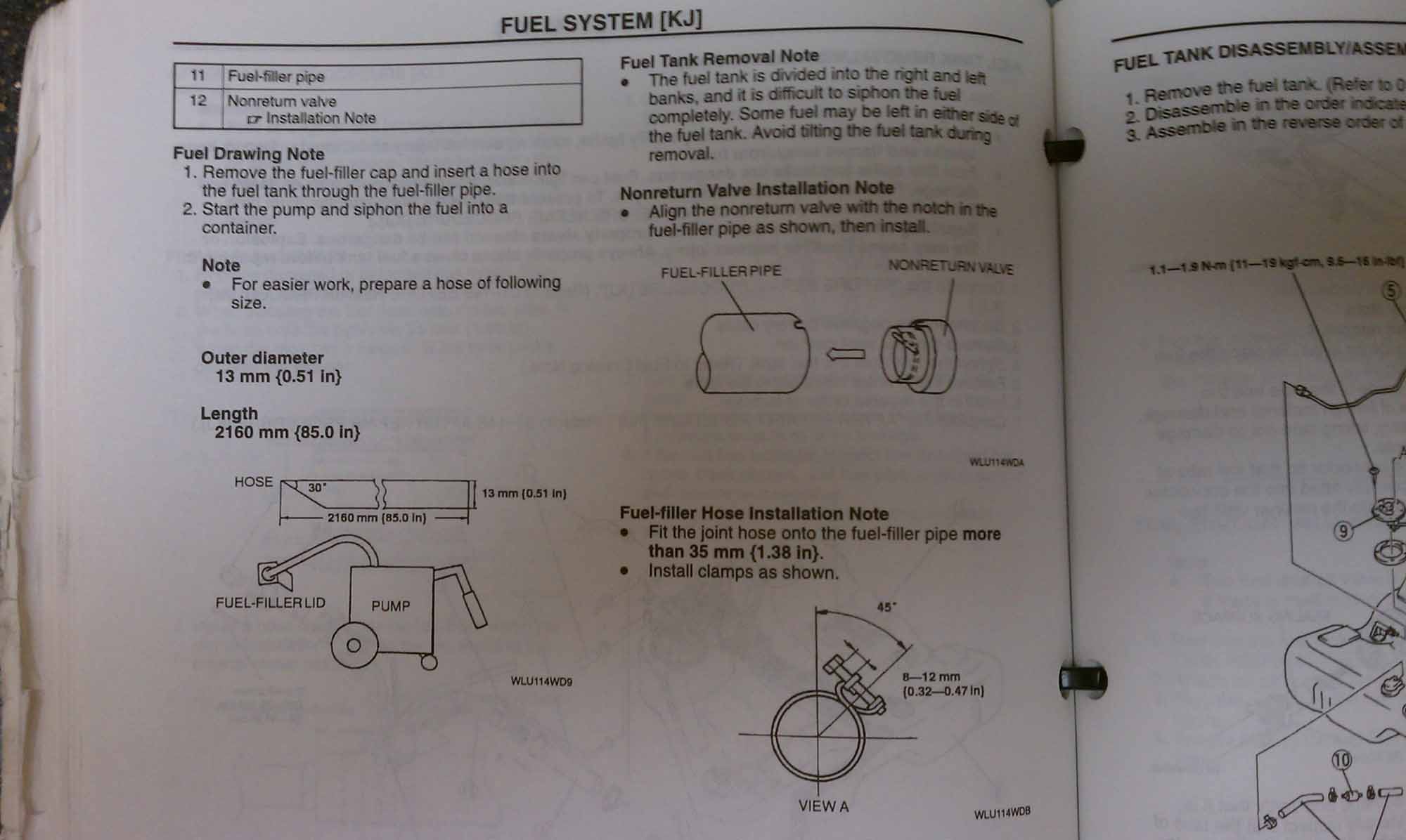

///BHRpowered Posted April 6, 2012 Report Share Posted April 6, 2012 Parked the millenia with around 6 gallons of total has in it, wanted less but @118 miles in a weekend I'm almost double my average yearly. so I have a transfer pump and hoses and simply wanted to siphon tank to near bone dry. nope. 3 foot hose wasn't even touching fuel. It almost feels like some sort of screen is in place in the filler neck to prevent siphoning. excellent work by Mazda with 4.25 prem gas, but hoe the crap I get the gas out Quote Link to comment Share on other sites More sharing options...

///BHRpowered Posted April 29, 2012 Author Report Share Posted April 29, 2012 That both pleases and annoys me. I would like a way to drain all fuel. Quote Link to comment Share on other sites More sharing options...

///BHRpowered Posted May 4, 2012 Author Report Share Posted May 4, 2012 Not good for the pump to run out of fuel, according to what lat posted the tank isn't flat and/or has multiple chambers - so it would be basically impossible to drain it all. I just want as much out as possible to prevent the hippy ethanol from ruining things, even with sta-bil Quote Link to comment Share on other sites More sharing options...

enginph Posted May 12, 2012 Report Share Posted May 12, 2012 Remove the hose that goes into the filter, connect an extension hose, and run the pump. Quote Link to comment Share on other sites More sharing options...
