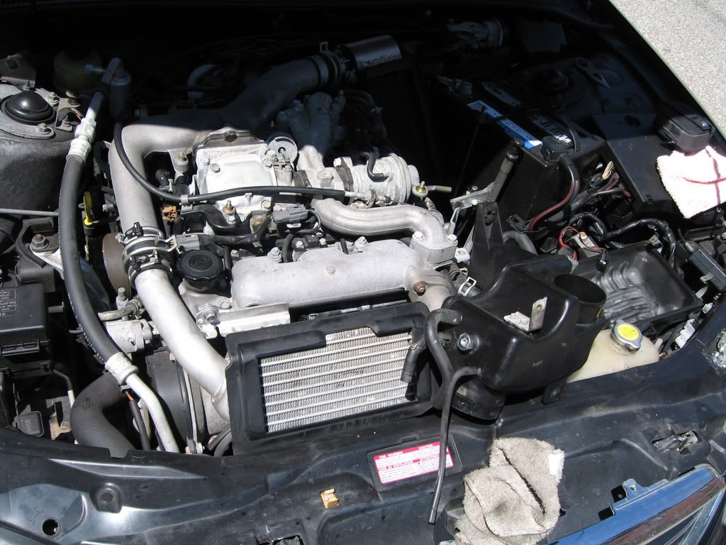

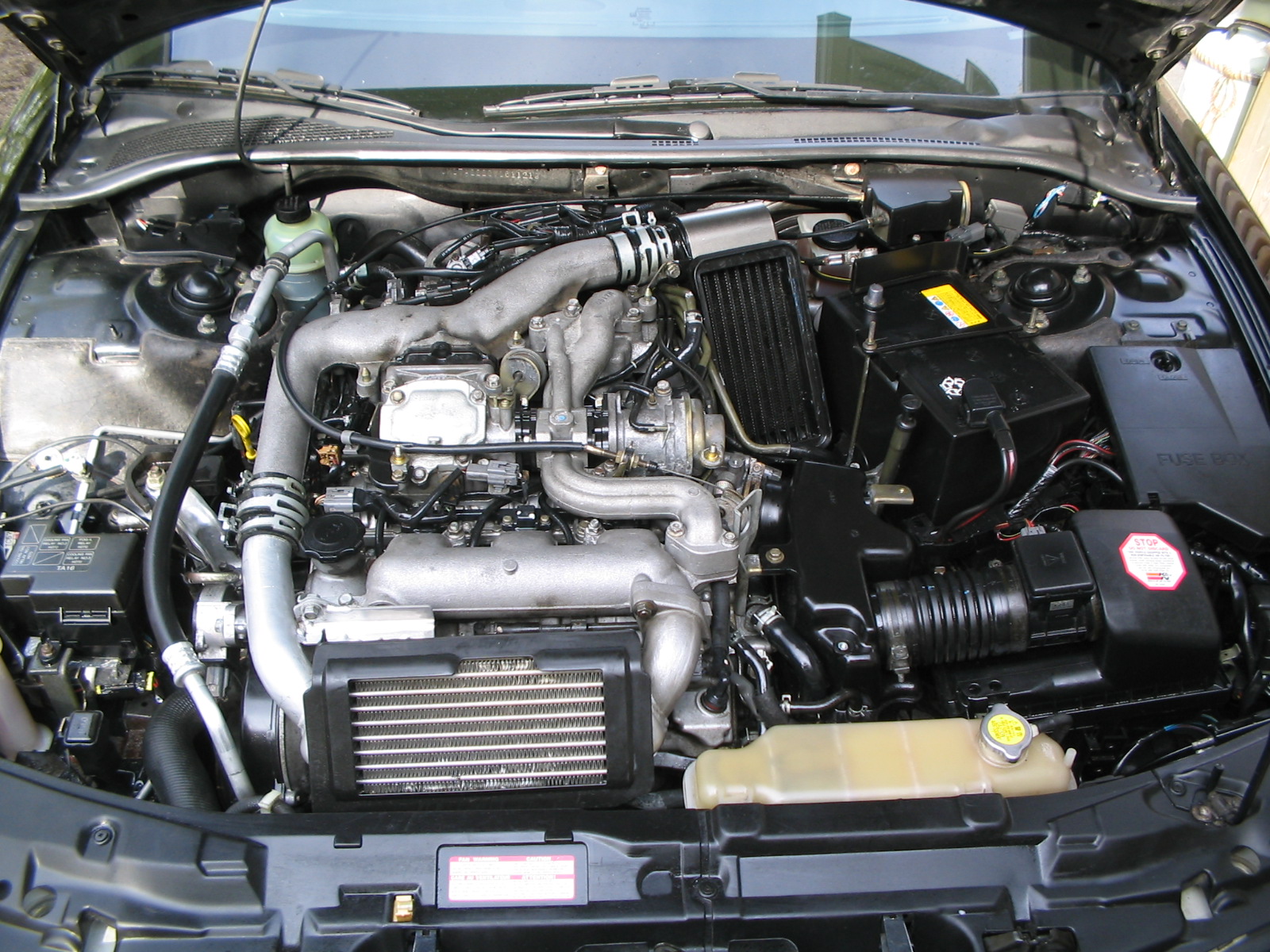

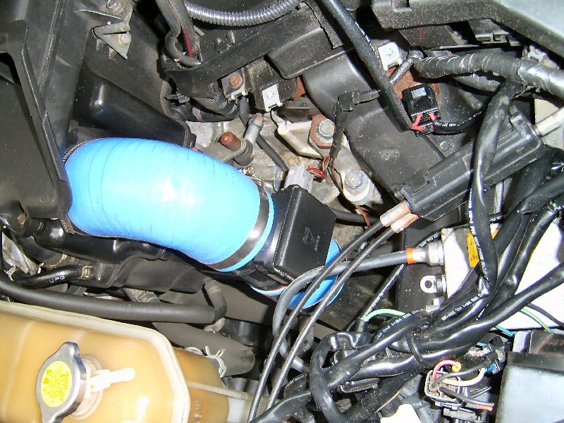

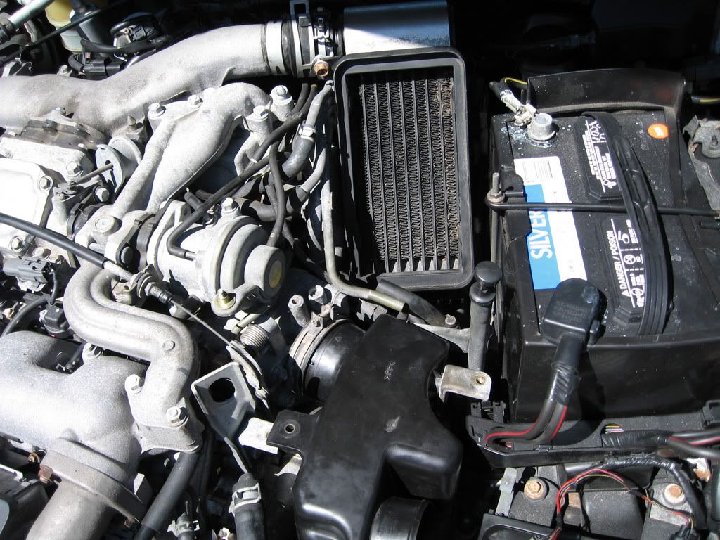

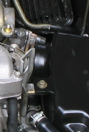

enginph Posted August 15, 2007 Report Share Posted August 15, 2007 So you mean taking out the resonator and putting a pipe which has 1/10th of volume of the resonator will increase the air flow? Sorry I dont buy it.. Besides i am sure they took into account where and at what angle to connect other pipes to the resonator so that the air flow wont be affected. Here are some pics. Â Â Â Â Â Link to comment Share on other sites More sharing options...
Frankzao Posted August 15, 2007 Report Share Posted August 15, 2007 It looks like the biggest obsticale is room. the resinater box looks like it was created to fit in the area it was placed and to add a large enough bend/air chamber for the intake. If there is room, straight on to the intake should work just fine. Â Â Nice pics! Link to comment Share on other sites More sharing options...
ChiTown Posted August 15, 2007 Report Share Posted August 15, 2007 all that is needed is a straight pip cut to the proper length with the 6 vacuum tube nipples attached with the correct diameter. there are 6 tubes going to the resonator box but 3 different sizes, some of the tubes may need to be extended as well to reach there new location on the pipe. Â the 90 degree silicone grommet at the top of the chitown intake can just be turned and pointed directly at the throttle body, either a hump style straight grommet or a 45 degree grommet attached to the throttle body will give you the proper angle to only need a straight pipe connecting the two. Â I will experiment with the design and post observations once a prototype is complete, but like i said, i am just too busy lately so this is going to have to wait for at least a month.... Â oh yeah, and the resonator box also hold up the duct for the rear intercooler securing it with a 10mm bolt, so it must be constructed so as to secure the duct properly once the box is removed and replaced with a pipe. Link to comment Share on other sites More sharing options...
mts Posted August 16, 2007 Report Share Posted August 16, 2007 So you mean taking out the resonator and putting a pipe which has 1/10th of volume of the resonator will increase the air flow? Sorry I dont buy it.. Besides i am sure they took into account where and at what angle to connect other pipes to the resonator so that the air flow wont be affected. Â Â Â In the understanding of fluid dynamics, you would know that a large volume box put into a system of smaller sized piping creates a resistance to flow, and creates turbulence. If there is a 3" line coming into the box and a 3" outlet, the rate of flow is limited by the volume of the inlet and outlet pipes. And the piping in the millenia actually is reduced to less than the cross-sectional volume of a 3" pipe where it is open behind the front bumper. What the "resonator" box does is just what the name entails, tunes the sound emitted on the inlet side of the intake to reduce the sound on the inlet side to an engine. As any fluid dynamic student knows, laminar flow is much more efficent than turbulent. This is why quality CAIs are always made from smooth wall piping with large smooth bends. And why any of that crap the sell on eBay that puts a spin on the air are crap, as the actually create a pressure drop at the nozzle area between the blade, and this low pressure area creates turbulence, and resistance to flow. Â Â Â Same as a resonator on the exhaust system does, it tones down the sound waves of the cylinder firing so that the sound is dampened and more constistent. If you have ever straight piped a vehicle's exhaust you would understand the effects of a resonator. It in effect caps off the high, obnoxious exhaust notes that the firing of the cylinders emits. An exhaust system without resonantor and/or muffler is loud and has a high frequency snap that is truly undesireable anywhere outside of the racetracks. Â As for the angle of entry, this is very easily obtained using another 45 degree flex pipe, and turning the current 90 degree one. Thereby creating a nice smooth path of flow into the throttle body. Â Â Â [attachmentid=767] [attachmentid=768][attachmentid=769] Â Â Â As you can see in the pictures the original intake, as you have, comes straight into the resonator box, as does the CAI. Now if the box was removed, there could be another nice smooth piece of 3" pipe placed in, turn the CAI 90 flex back toward the throttle body inlet, place the pipe in, and then a 30-45 degree flex added to join the new pipe to the throttle body. I zoomed in on the throttle body union, and there is just a clamped on tube there also, so this is very do-able. The reason I am saying 30-45 degrees, is because the throttle body inlet has a slight turn towards the front of the car. Â The only other problem that will arise, as Renboy and I have already discussed, is that the rear intercooler ducting bolts down in 2 places in the resonator box. So something would have done to accomodate for this. Link to comment Share on other sites More sharing options...
ing-schu@online.no Posted August 16, 2007 Report Share Posted August 16, 2007 So you mean taking out the resonator and putting a pipe which has 1/10th of volume of the resonator will increase the air flow? Sorry I dont buy it.. Besides i am sure they took into account where and at what angle to connect other pipes to the resonator so that the air flow wont be affected. Â Â Â In the understanding of fluid dynamics, you would know that a large volume box put into a system of smaller sized piping creates a resistance to flow, and creates turbulence. Â Not if the volume is big enough to slow down flow! I'm not saying this box is big enough though. On modern sports bikes the (often ramaired) airbox is comparable with the fueltank for size and plays a major role in performance throughout the revrange. Link to comment Share on other sites More sharing options...
