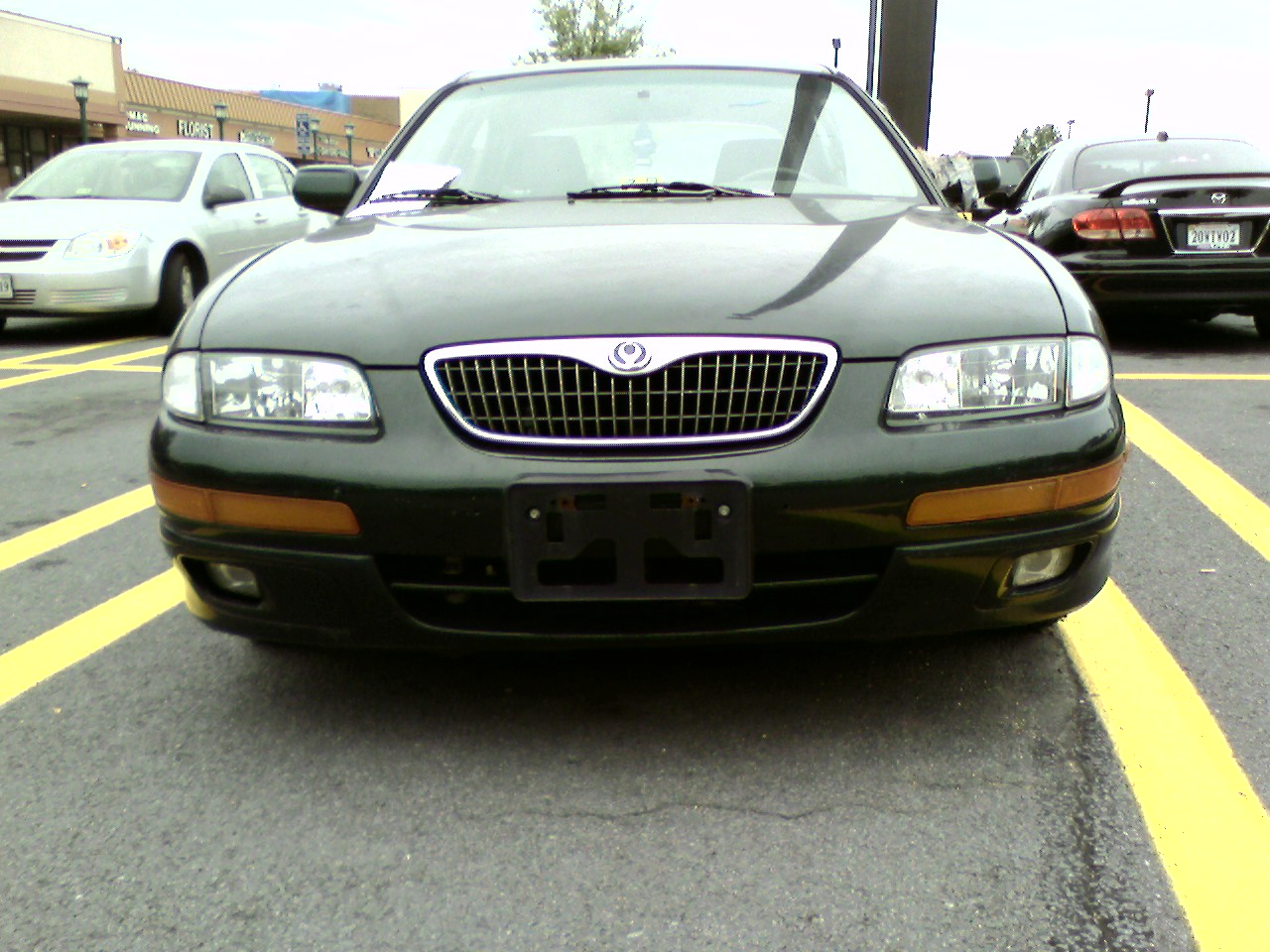

My new/rescued Millenia
*Shield your eyes, its very hard to look at one in this condition, this is why I have undertaken the task of restoring its former pre-ghetto rat glory*
1997 2.5 L, 112k.

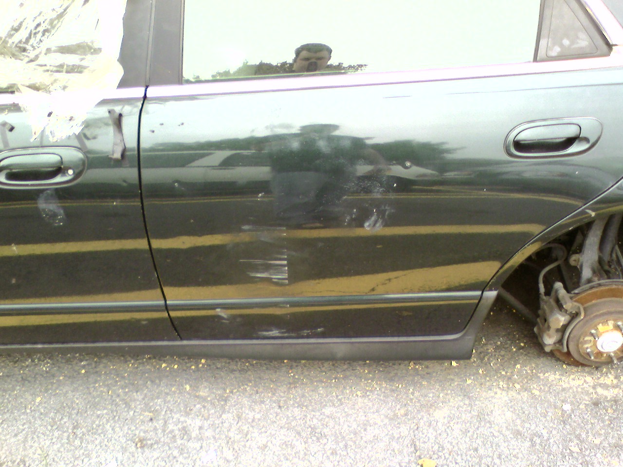

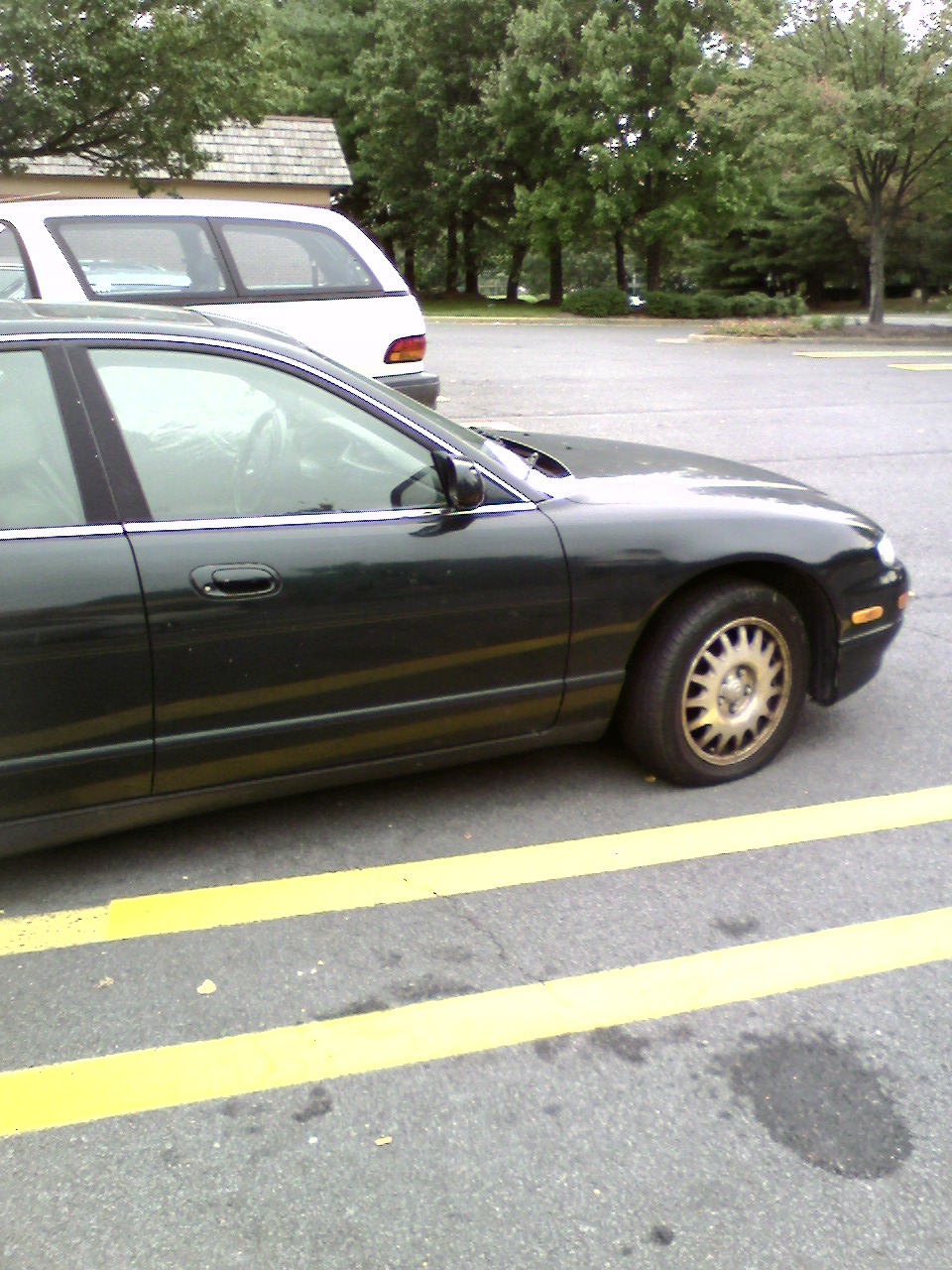

Interior is in fairly excellent condition all things considered, just needs a good cleaning, and drivers carpet has oil stains from where spark plugs were sitting.

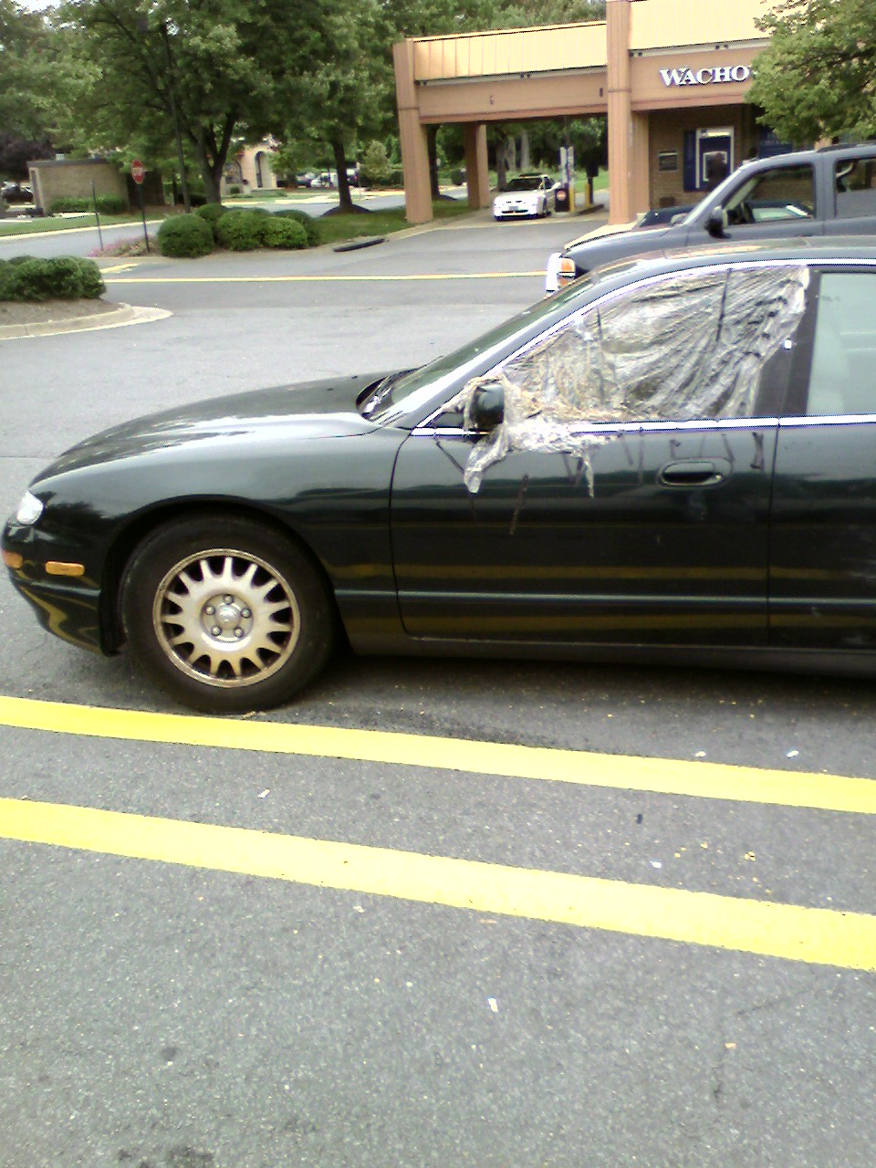

Exterior is in good condition all things considering, just 1 problem with the door as pictured, and the window

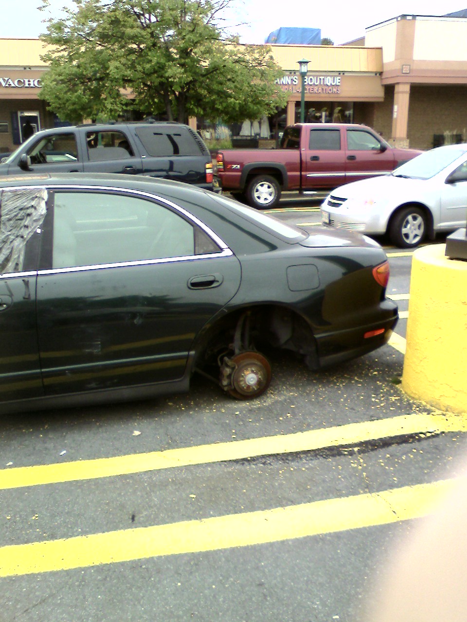

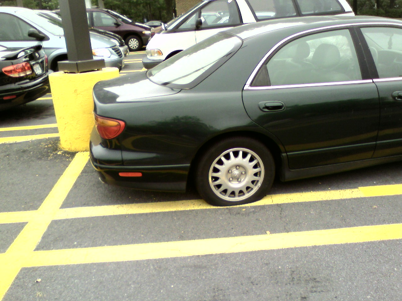

2 flat tires, 1 wheel missing all together, another tire vastly over inflating or belts have seperated.
Car is unlocked, valve cover screws and spark plugs are sitting on floor in drivers seat, random trash, and pine smell from cheap cab air freshener thingys.
Engine bay - Valve cover is removed and set aside, plugs and wires have been removed, dipstick has some sludge on it (as expected), transmission fluid is still good in color, coolant is slightly brown, but not milky.
Based on what has been removed I assume there is a bent rod somewhere, which one the 2.5 I can fix.
My goal is to drain all fluids, period. refill all fluids, replace valve cover, plugs, plugs etc. try to turn car over with fresh fuel, run for a few minutes, add oil cleaner, then drain again, then put in truely fresh oil and new filter.
From there get an extra rim, but on some decent tires all around, rotors must be changed but I still have my old ones.
Aside from that, which will be alot of work, I can get it started, see what if any other problems it has, check for codes etc. if all checks out, put a new battery in, bhr detail the interior and exterior and I have another fully functioning millenia.
*If this does not work out, or engine has serious problems, I will simply part out the car*
Now you may be asking how I got this, especially for only 25 dollars. well, car had been abandoned for almost a year that I alone know of, I filed the paperwork to claim it, county impounded it and wanted to sell at public auction, but because it was undriveable simply assigned title to me. I just need to rent a u-haul trailer with a manually winch, slap on my millenia's spare, get it on a trailer, tow home with jeep, and set up a car tent in the yard for it.
